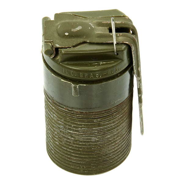

Here are a couple more curious ones. The OD I'm pretty sure is marked for Brazil, but I have no documents on. The white one I have no information on. The spoon looks US, but there are no marks on anything. The grenade is filled with a void in the center, the fill material is similar in appearance to cement and does not test out as energetic or hazardous (Ahura).
View attachment 150207View attachment 150208View attachment 150209View attachment 150210View attachment 150211View attachment 150212View attachment 150213View attachment 150214
The OD is a Odeti M1 from Brazil.
