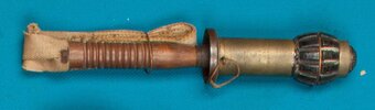

I was randomly looking on the web and came across this.
An interesting selection.
My query is regarding the number 2 on the left. Is that right? (The collar between the stick and the brass body of the grenade).
Dave.
On the face of it, it is not right. The "collar" is a range reducing disc used on the No.2 grenade used by the French Army with their 8mm Lebel. It appears that either some enthusiast in the past has taken a No.2 8mm rifle grenade body and rammed a hand grenade handle into its base plug, or perhaps it was a less well-known French field conversion of a rifle grenade to a hand grenade - in British service the No.2 RG was officially converted to the grenade, hand, No.2, Mk I (with long cane handle), and then the Mk II with short handle.

Thanks Tom, I did wonder if there was a potential official or field conversion based purely on the quality of the other grenades that were for sale, but then "made up" items can creep into even the best collections.
