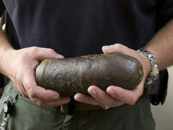

http://www.knoxnews.com/videos/detail/stumbling-upon-unexploded-civil-war-artillery-shel/
Dave Sink held a piece of that history in his hands Tuesday night when he pulled an unexploded Civil War artillery shell out of a muddy creek bank .....
http://www.knoxnews.com/news/2008/aug/15/history-shell-of-former-self/
